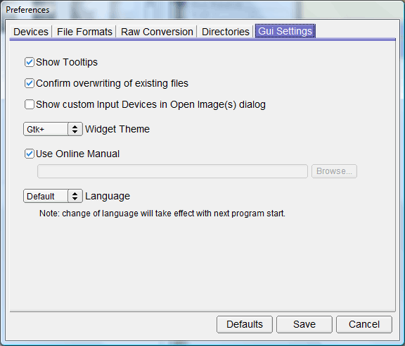

| Dialog Gui Settings |
Show a help text if the mouse is moved over a Gui element.
Protects against unintended overwriting when saving an image.
This switch activates the use of custom Parameter Sets within the file choosing dialog.
The look of the Gui elements can be adjusted via "themes".
With active switch the program uses the online HTML manual from the FDRTools website. If you wish to read "offline" you may also use a HTML manual that is saved locally on your computer. Note that the HTML manual is not part of the software. If you want to use this option go to download pages of the FDRTools web site, load the HTML manual (ZIP archive) down to your computer, unpack the archive somewhere on your computer and navigate to this place via the "Browse..." button.
Sets the language used to display texts in the program. Changing the language setting will take effect with the next program start. The default language is taken from operating system settings.
